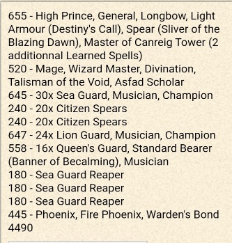

  • 10. from 20.
    14:6 vs DL
    13:7 vs HE
    4:16 vs DL again
    Metal was totally the right option. Attribute and flaming for the win.
    Traumdieb was definitively right regarding the need for a skirmishing unit of white lions.
    On the Spearlord I might try destinies Call next.
    I am at the moment thinking about flaming Banner on one of the Seagards.
  • Heiner did good, too. He took highest born Highelf from the Sylvan Elves I had hired to stopp him from that. Pherhaps my orders should have been clearer to the ETC2019 Team. I should have made sure they look when I said make sure this Highelf is highest Highelf. But it seems Paul and Thomas did not look and so made the wrong highelf the highest one. (=Heiner played Zwase with his Sylvan Elves and I played Dekadenz with his DL in round 3 after Heiner and I met in round 2.)
